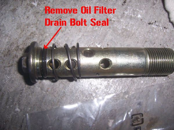

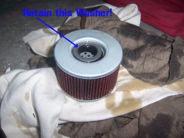

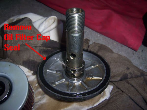

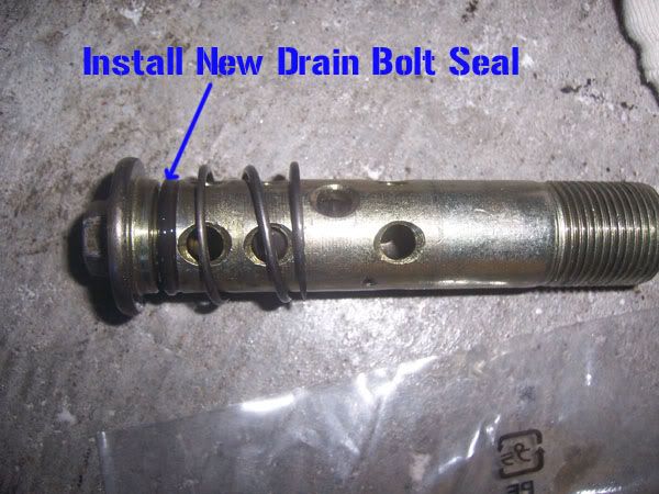

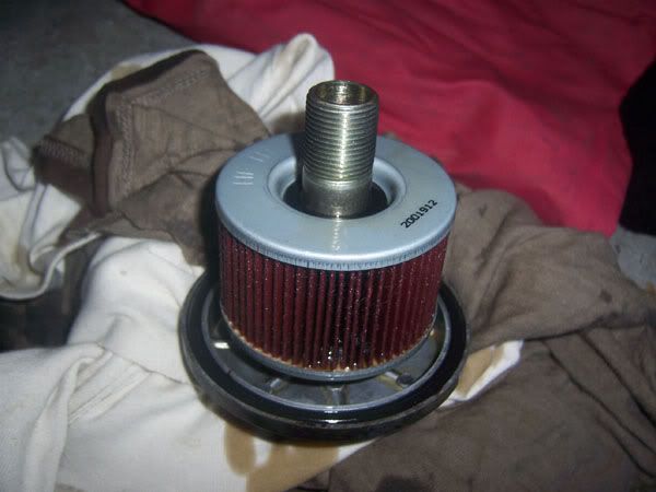

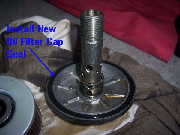

So you've removed the oil filter assembly from the engines sump like this:
Remove old filter and retain the metal washer on the bottom side of the filter.
Remove old seal from oil filter cap.
Remove old seal from oil filter drain bolt.
Install new seal on the oil filter cap, (lube the seal with a small amount of new oil).
Install new seal on the oil filter drain bolt, (lube the seal with a small amount of new oil).
Install the old washer in-between the oil filter and spring,
Soke the new oil filter in fresh oil then, Install the new oil filter (Writing on the filter faces up).
Done! Ready to install back into the sump!

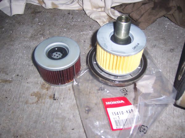

when i went to Honda and asked for a oil filter for the mc22, it came with the oil filter, and the 2 oil seals in one sealed bag.

it doesn't really matter what thickness the washer is, its only there to stop the the spring from exerting pressure onto the rubber inner of the oil filter (which may push through or damage the rubber), instead it exerts it over the metal washer and it distributes it evenly onto the rubber of the oil filter.

got the bits and pieces i needed to do an oil and filter change today...got the parts from Team Moto Honda in Moss St, Slacks Creek (QLD for those playing at home)...I also grabbed the washer that sits between the filter and the spring.
the washer seemed expensive for just 1 little washer, but i got it anyways as it was just easier...turns out there wasn't one on the bike so it saved me from hunting for a suitable washer at home anyways.
part numbers and prices are as follows (genuine parts):
oil filter (the 2 o-rings included): 15410-KEA-305 $17.38
washer: 15414-300-000 $4.36
