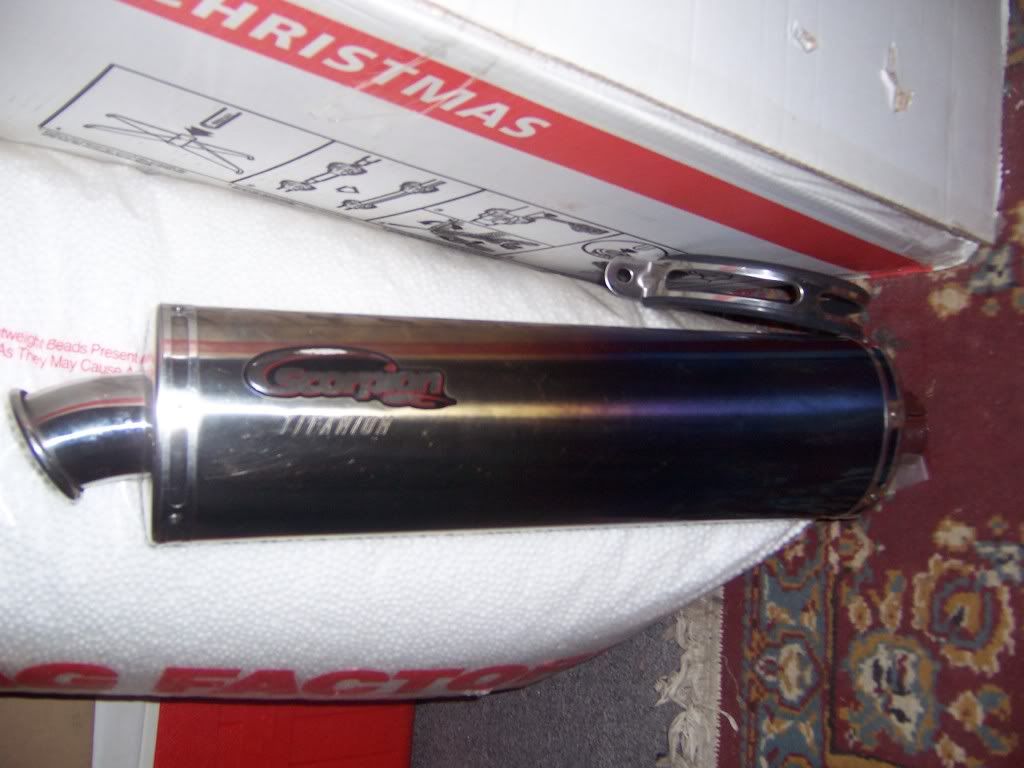

you can weld on a flange to suit any exhaust you want, all you need is the right dimensions and you can make 1 up yourself if you have the tools if not go to an engineering shop or similar they can make 1 up easy. i recently aquired a scorpian exhaust off a cbr 600 only used once before bike blew up gonna put it on mine
