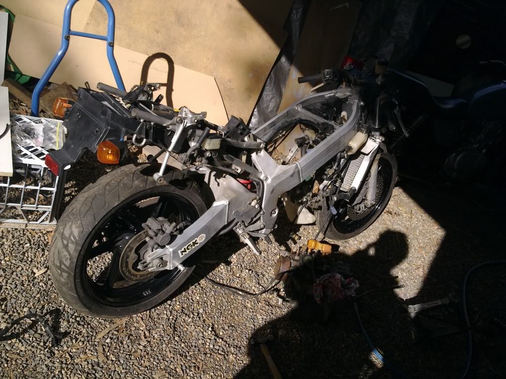

i managed to pick up an old beat up nsr250, many parts missing and good condition compared to what has been done to it.
the story goes, "the engine blew" took the heads barrels and pistons off. realized how much it would cost to get the barrels re-plated, then left it in the weather with the top-end off for total of 3 years! while he thought he would save up to fix it....

how i bought the bike...

the strip down..

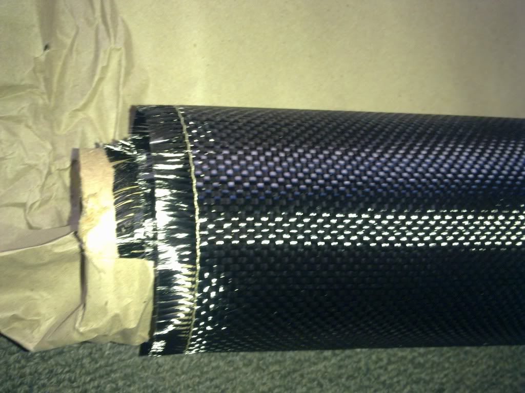

ok, finally getting the hang of this carbon business. quite a tricky job getting the carbon down smooth while having incredibly sticky fingers and epoxy everywhere! Then waiting hours to cure in this damn winter cold. thinking about investing in a vacuum bagging set up.

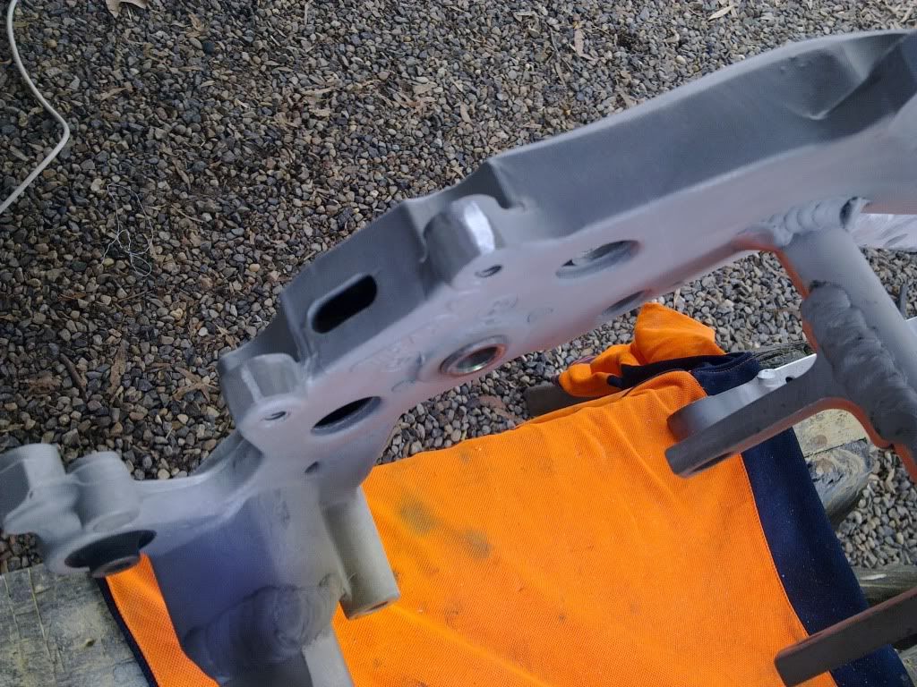

Frame work...
one thing i love on bikes is a beautiful fame, the easiest option is to paint it black but i love the original brushed look.
so i've work hard and long sanding and grinding away at the frame almost finished prepping the frame,
been sanding it back and grinding away at the excess castings really cleaning it up.
i would get it powder coated but from factory i believe they are anodized. powdering coating over anodizing if you have not removed the anodizing properly results in bubbles and crap all through the powder coating, the only way to remove the anodizing is to soak it in caustic soda. to do that i would have to remove the hardened steel bearing seats and the rubber engine mounts. these are a pain to press back in so as result i will clear the frame.
there are many different forms of clearing but one gets remarkable results and doesn't go yellow in color when exposed to uv rays for an extended period of time.
2 pac and acrylic both tint yellow, so i will be using a product called nycote, its bloody expensive at $165 a liter.
[hr]

So before everyone else asks... how hard is it to start making basic shapes out of carbon fibre.
Any helpful links you might be able to put up?
Would you be interested in making a couple of one of small pieces for other forum members?
· Registered
Joined
87 Posts
Discussion Starter · #20 ·
very basic parts are fairly easy, to get started very expensive for small stuff.
talking $100pm for carbon, $70 + for epoxy resins, then need acetone for cleaning, mixing cups, gloves, and brushes. then need to clear coat with either 2 pac or nycote..
cant buy 2 pac in pressure packs (that i know of) but can get nycote for $58 per 300g can. other alternative you will need air compressor and hoses, water trap and of course the gun, then you need the paint...
as you can see it all adds up but at the end of the day you have all the equipment and some supplies and this opens many doors. only thing you need is time.
once i do a few more parts i prob will offer it to someone who is willing to loose their heel and chain guards for 2 weeks while i make some molds in return for some carbon parts.
