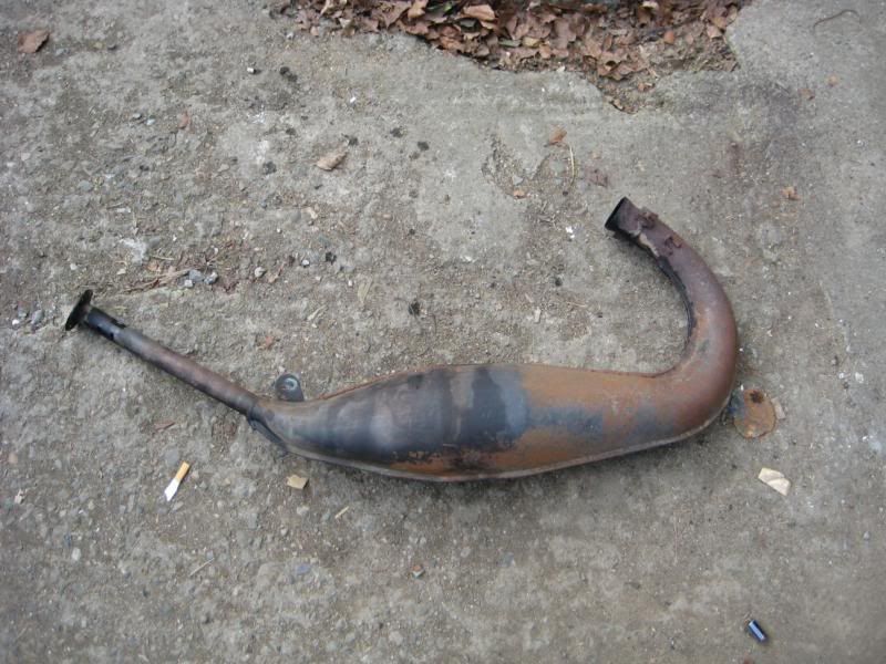

So today I spent some time with the grenade.
I sanded down the exhaust (Which Is a Bitch to get off!) and sprayed it wit Very High Temperture paint.
Before
After
It looks as good as New![:D]
The end can has seen beter days and may be replaced by ebay if the funds can handle it.
SO much 2stoke oil leaked out of it that I reckon its been running rich for years.

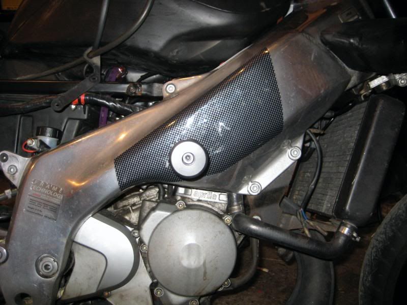

Today I got down and durty with my new itialian girlfriend!
I removed the rad and I have to say she is in great Nick!
back to high res pics Keith
just getting started
water ports.
T he power power blade came out, I know I thought it was a funny name too!POWER BLADE!!!
Head off, the piston is in fairly good Nick, the bike has 9,400 miles on her and it's hard to tell if she has been rebuilt before.
side angle
The cylinder is in pretty good shape too! I am happy enough to put it all back together wit a new piston, small bearing, gudgen pins and rings.

I added some very dodgily cut frame protection hard sticker. This adds 10 bhp to the bike!

Fit the brand new never used exhaust I was given by the same lad and

They were off a brand new RS125 that was stripped to race and they sat in an attic for a couple of years!
Cost me 200e for all of them plus a brand new exhaust as he put an arrow system on the bike first thing.
