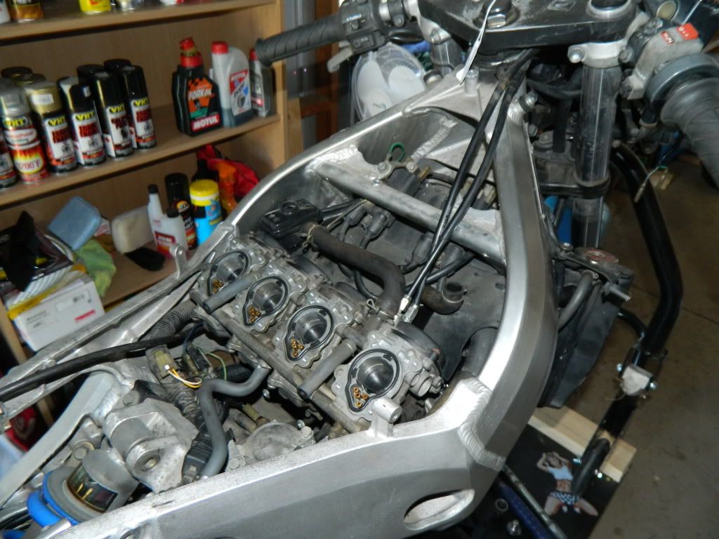

I started by re-installing the carbys, I was going to strip these down and clean them but wanted to check if the bike would run first as I was a little too keen to see if it would run.
